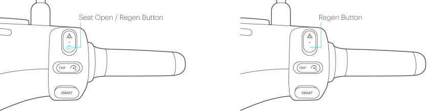

  • The power recovery rate can be adjusted or turned off through the Gogoro® App. When regenerative braking is activated, you will feel a braking force on the rear wheel. The higher the power recovery rate you set, the stronger the braking force.

    Note: You can turn on or turn off regenerative braking function by pressing the “Regen” button on the right hand side. (Please refer to the chapter: Before you hit the road)

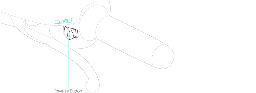

Reversing ( On certain models only )
Please follow the instructions below to reverse:
  1. Make sure the scooter is started and is in motor standby mode.
  2. Make sure the scooter is in complete standstill and its electronic throttle is not activated.
  3. Press the reverse button, the Smartscooter™ will reverse slowly with flashing and audible warning sign.
Note: The electronic throttle will not respond while the the reversing function is activated.
Note: The reverse throttle will not respond while the Smartscooter™ is moving forwards (gliding or being pushed), and the reverse power will be inactive until the Smartscooter™ is fully stopped to 0 km/h.
