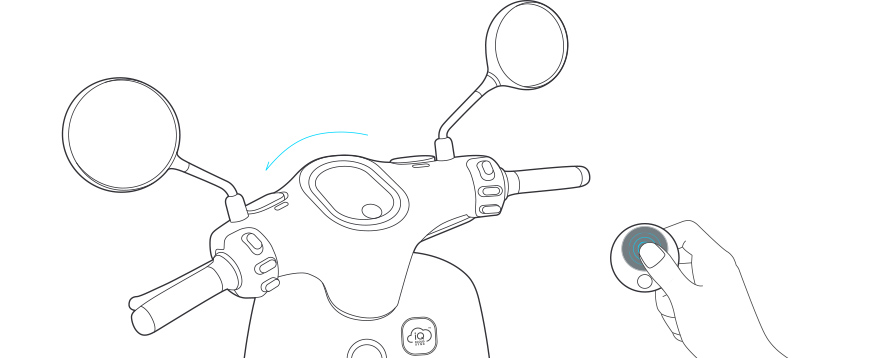

  1. If your Smartscooter™ is locked, turn the handlebar all the way to the left, then press the button on the iQ System™ Smart Key to unlock it.
  2. The headlight and tail light will flash, an audible tone will sound, the handlebar will be unlocked and the dashboard will light up to confirm the unlocking command.
Note: If no further action is taken after unlocking for a period of 3 minutes, the Smartscooter™ will lock itself automatically.
Note: Turn the handlebar all the way to the left end, before you unlock the Smartscooter™, or the handlebar lock may not successfully be released.
Note: Every time when you unlock the Smartscooter™, before you ride, turn the handlebar all the way to the left end and make sure the handle bar lock is successfully unlocked.
Every time when you lock or unlock the Smartscooter™, make sure the handlebar is turned all the way to the left end.

  1. If the Smartscooter™ is unlocked, turn the handlebar all the way to the left, then press the button on the iQ System™ Smart Key to lock it.
  2. The headlight and tail light will flash, an audible tone will sound, the handlebar will be locked and the dashboard will dim to confirm the locking command.
Note: Every time when you lock the Smartscooter™, turn the handlebar all the way to the left end and make sure the handle bar lock is successfully locked.
